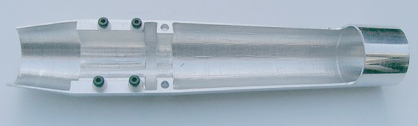

As well as the items shown in the heading photos, Alexander can supply a speed pan, shaped to match the spinner, and a tuned pipe:
TOP-3 pan
Note: in contrast to the Free Flight Cyclon-06 engines, where the side flanges are intended to stiffen the case and to provide a place to mount flood off devices etc., the flanges on the 049 (and 051) are evidently considered strong enough to be used as beam mounts for a speed pan installation. The pan has been machined out to clear the engine's radial mounting. This is the purpose of the semicircular slot between the engine mounting points and the pickup points that attach the pan to the model.
This pan can be made to fit the 1/2A Newton/Hughes sidewinder speed kit, which was designed for the GZ 049 engine. The Cyclon pan is slightly narrower than the GZ pan but this is soon fixed with a bit of fibreglass work. Its internal machining differs too, though this isn't a problem.
